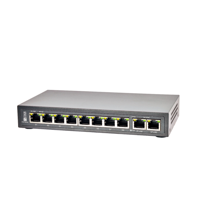

High-performance 8-port Gigabit PoE switch with two additional gigabit uplink ports for seamless connection to your router or network backbone. Delivers up to 250W total output power to IP cameras, access points, and PoE-enabled devices. Features include IEEE 802.3af/at support, automatic detection, port prioritization, and built-in diagnostics – perfect for surveillance systems, business networks, and smart home setups.

The IN-PoE 8250 is a high-performance 8-port Gigabit PoE switch with full IEEE 802.3af/802.3at support – ideal for IP cameras, wireless access points, and other PoE-enabled devices. In addition to the 8 PoE ports, the switch features two dedicated Gigabit uplink ports for fast and stable connectivity to your router or network backbone. With automatic device detection, intelligent power management, and 1000 Mbps data transfer, it ensures efficient and reliable networking via a single Ethernet cable. Important: Power is transmitted via PoE pins 4 & 5 (+) and 7 & 8 (−). Please verify the compatibility of your end device to avoid potential damage.
Effortless Plug & Play
Setup is as easy as it gets: connect your PoE devices and plug in the included power adapter. No configuration required – true plug-and-play convenience.
No Extra Power Cables
All eight Ethernet ports support PoE – a single Cat.5e/6 cable delivers both power and data. Ideal for locations without nearby power outlets or where cable clutter should be reduced.
Smart Power Supply with Port Priority
Each PoE port delivers up to 30 W (IEEE 802.3at), with a total power budget of 250 W. Integrated port priority protects your setup by disabling lower priority ports (e.g., port 8) in case of overload.
Built-in Diagnostics
Built-in diagnostic LEDs allow you to quickly identify cable faults or short circuits – for a stable and secure network setup.
